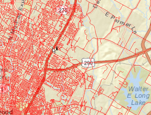

You can overlay your data onto a background map, which allows you to view your data in context.
For example, if you have a dataset that contains roads in a specific city, you can overlay this data1 Background Maps: ArcGIS Online: Sources: Esri, DeLorme, NAVTEQ, USGS, Intermap, iPC, NRCAN, Esri Japan, META, Esri China (Hong Kong), Esri (Thailand), TomTom, 2013 MapQuest: Tiles Courtesy of MapQuest Stamen: Map tiles by Stamen Design, under CC BY 3.0. Data by OpenStreetMap, under CC BY SA. onto a background map of the same area:
When you apply a background map, both the dataset you open and the background map dataset appear together in the View window and the Display Control.
Only features of the dataset you open can be selected for viewing in the Feature Information window or Table View. You cannot zoom in or otherwise change the view of the background map: the focus is always on your own data.
