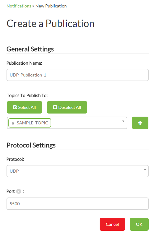

The following example UDP publication receives UDP messages on port 5500 and publishes notification messages to topic SAMPLE_TOPIC.
