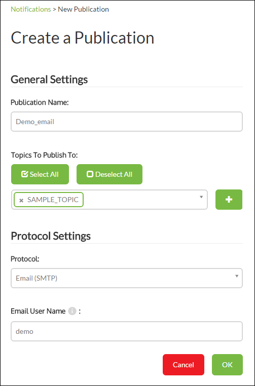

To configure an Email (SMTP) Publication, open the Web User Interface and select Manage > Notifications (or, from the Home page, Create Notification), and provide the following:
  • A name for the publication.
  • One or more topics to receive notifications.
  • Protocol Email(SMPT).
  • Email User Name: Enter the user name of the e-mail address on the FME Server host system that receives the e-mails. For example, if the e-mail address is user@serverhost.com, enter user.
  • Note: Email addresses cannot be duplicated across Email publications. There must be a unique email address for each email publication. Email addresses are case-insensitive.
Click OK.
The following example Email (SMTP) publication receives email messages at demo@myserver, where myserver is the host name, and publishes notification messages to topic SAMPLE_TOPIC.
