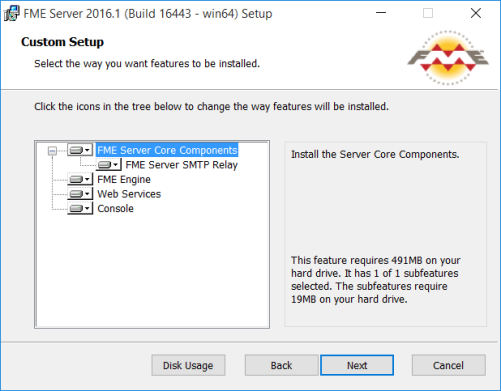

  1. Start the FME Server Installer.
  2. On the Choose Setup Type dialog, select the Distributed install option.
  3. On the Custom Setup dialog, select FME Server Core Components, FME Engine, and Web Services. (Optionally, select Console. For more information, see FME Server Console.)

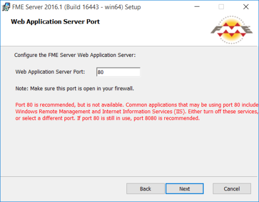

  12. On the Web Application Server Port dialog, specify the port to use for communication with the web application server. Port 80 is the recommended default. If this port is in use, port 8080 is recommended.
  13. Note: Common applications that may be using port 80 include Skype and Internet Information Services (IIS). Either turn off these services, or select a different port, such as 8080.
