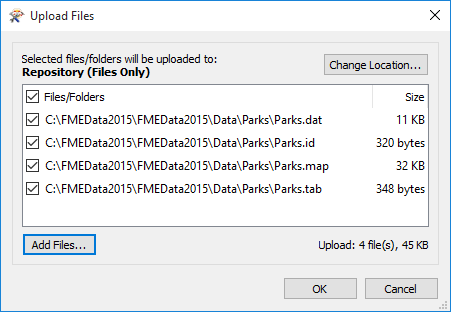

Upload data files: If the workspace, custom transformer, or custom format has file resources that need to be uploaded, check this box. Then, click Select Files to verify the list of files to be uploaded.
Select Files: Opens the Upload Files dialog, where you can select from the list of available file resources that need to be uploaded with the workspace.
Note: For information about uploading shared resources, including custom formats, custom transformers, and custom coordinates systems, see Sharing Custom Formats, Transformers, and Coordinate Systems on FME Server.
To add or remove files and folders from being uploaded, check or clear their respective check boxes. To add more files, click Add Files.
At the top of the dialog is indicated where the files are uploaded in FME Server. In this example, the files are uploaded to Repository, which means the repository specified in the Publish to FME Server dialog.
To change the upload location, click Change Location.

Click OK to close the Change Upload Location dialog. Click OK again to close the Upload Files dialog.
