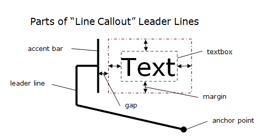

FME supports “Simple Line Callout” and “Line Callout” annotation leader lines represented as format attributes. Common between both are tolerance, line width, line color, and the anchor point. Simple Line Callouts can optionally have a geometry associated with them stored in geodb_leader_line. Line Callouts in Geodatabase have no geometry associated with them and are rendered directly in ArcGIS based on their attributes. To assist in emulating the rendering, FME provides a textbox envelope that can be used along with the style, gap, margin and anchor point attributes to determine where to place the leader line and accent bar.
Leader lines attributes will only be on annotations with an actual leader line. If the annotation is split, then the leader line attributes are only placed on the first part with the textbox being the envelope of the whole annotation.
Leader line attributes will override leader line symbols if a symbol id or annotation class id is provided. If just providing an anchor point, only the anchor point will be overridden; otherwise, the whole leader line symbol will be overridden.

geodb_text_leader_line |
The geometry of the leader line of type “Simple Line Callout” associated with the annotation, if present. It will be stored in OGC WKT format. |
geodb_text_leader_line_anchor_point |
The geometry of the leader line anchor point associated with the annotation, if present. It will be stored in OGC WKT format. |
| geodb_text_leader_line_tolerance | The leader tolerance of the leader line in ground units associated with the annotation, if present. The leader tolerance is the minimum distance the text should be from the anchor point before a leader line is drawn. |
| geodb_text_leader_line_width | The width of the leader line in ground units. |
| geodb_text_leader_line_color | The RGB color of the leader line. See geodb_color for a description of how color is represented in FME. |
| geodb_text_lc_style |
The style of “Line Callout” type leader lines. Options: base, midpoint, threepoint, fourpoint, underline, custom, circularCW, circularCCW |
| geodb_text_lc_gap | The gap is the space in ground units between the margin and the accent bar for “Line Callout” type leader lines. |
| geodb_text_lc_margin_left | The left margin in ground units of “Line Callout” type leader lines. |
| geodb_text_lc_margin_right | The right margin in ground units of “Line Callout” type leader lines. |
| geodb_text_lc_margin_top | The top margin in ground units of “Line Callout” type leader lines. |
| geodb_text_lc_margin_bottom | The bottom margin in ground units of “Line Callout” type leader lines. |
| geodb_text_lc_accent_bar_width | The width in ground units of the accent bar of “Line Callout” type leader lines. |
| geodb_text_lc_accent_bar_color | The RGB color of the accent bar of “Line Callout” type leader lines. See geodb_color for a description of how color is represented in FME. |
geodb_text_lc_textbox_x1 geodb_text_lc_textbox_y1 geodb_text_lc_textbox_x2 geodb_text_lc_textbox_y2 geodb_text_lc_textbox_x3 geodb_text_lc_textbox_y3 geodb_text_lc_textbox_x4 geodb_text_lc_textbox_y4 |
The four coordinates of a bounding box around the text. This bounding box may be rotated. The textbox along with the margin and gap can be used to determine the start position of the accent bar and the start position of the leader line for “Line Callout” leader lines. These are read-only attributes. |

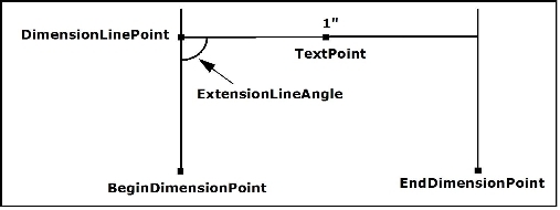

geodb_dim_text_angle |
The angle of the text displayed, in radians. From Esri’s documentation: "The TextAngle property will only affect the dimension if the dimension's style's text alignment property is True in which case the text is always parallel to the dimension line." Default:0 |
geodb_dim_extn_line_angle |
The angle (in degrees) between the dimension line and the extension line. Default:90 |
geodb_dim_begin_dimension_x |
The X value for the Begin Dimension Point. |
geodb_dim_begin_dimension_y |
The Y value for the Begin Dimension Point. |
geodb_dim_begin_dimension_z |
The Z value for the Begin Dimension Point. |
geodb_dim_end_dimension_x |
The X value for the End Dimension Point. |
geodb_dim_end_dimension_y |
The Y value for the End Dimension Point. |
geodb_dim_end_dimension_z |
The Z value for the End Dimension Point. |
geodb_dim_line_x |
The X value for the Dimension Line Point. The Dimension Line Point determines the height of the dimension line above the baseline. To create a two-point dimension, the Dimension Line Point must be the same as the Begin Dimension Point. |
geodb_dim_line_y |
The Y value for the Dimension Line Point. The Dimension Line Point determines the height of the dimension line above the baseline. To create a two-point dimension, the Dimension Line Point must be the same as the Begin Dimension Point. |
geodb_dim_line_z |
The Z value for the Dimension Line Point. The Dimension Line Point determines the height of the dimension line above the baseline. To create a two-point dimension, the Dimension Line Point must be the same as the Begin Dimension Point. |
geodb_dim_text_x |
The X value for the Text Point. If the x,y,z values for the text point are all zero then the default text position is used. Default:0 |
geodb_dim_text_y |
The Y value for the Text Point. If the x,y,z values for the text point are all zero, then the default text position is used. Default:0 |
geodb_dim_text_z |
The Z value for the Text Point. If the x,y,z values for the text point are all zero, then the default text position is used. Default:0 |
