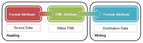

When a translation is carried out, the following occurs:
This is why, when a user inspects data, there are two sets of attributes.
Using this method, FME can convert from one format to another, without having to separately map the source format attributes to the destination format attributes for every format.
FME simply converts everything to an FME standard, and then from there to the Writer Format.

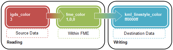

The benefit of using generic attributes over format-specific attributes is that they have the same meaning in all the readers and writers that support them. For example, the fme_color and fme_fill_color feature attributes represent the red, green, and blue intensities of a feature. If a format has generic color support, the reader will add both the generic FME color attributes and the format-specific color attributes to features. Writers that support generic color will give precedence to the format-specific color attributes if they are present in addition to the generic attributes.
