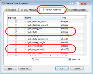

To expose a format attribute, open the Feature Type Properties dialog, and click the Format Attributes tab. Locate and select the Format Attribute to expose. Click OK to make the format attribute available for use in Workbench.
Format attributes might be a single attribute (for example, igds_style) or they might be a list-based format attribute, for example (igds_tag_names{})

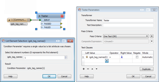

In this example, we have exposed the list format attribute igds_tag_names{}.
If we attempt to use that attribute in a Tester transformer, we are prompted to choose which element in the list is to be tested. Because transformer dialogs ask which element in a list is to be used, it is not necessary to have to expose multiple elements solely to get access to a single one.

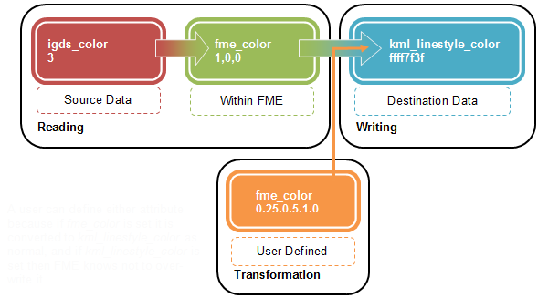

When writing data, FME attributes are turned into format attributes that reflect the data as it is supposed to be written. However, a user can override this process by predefining the value of these attributes before they are sent to the writer.
In other words, setting a format attribute may cause a transformation in the data to take place. Either the writer format attribute (here kml_linestyle_color) or the equivalent FME attribute (here fme_color) may be set to achieve the same end.
A user can define either attribute because if fme_color is set, it is converted to kml_linestyle_color as normal, and if kml_linestyle_color is set, then FME knows not to overwrite it.
If a user manages to define both a format attribute and its FME equivalent, then the format attribute takes precedence and is used. For example, set fme_colorandkml_linestyle_color, and the kml attribute gets priority.
This only really becomes a problem when reading and writing the same format, and the same format attributes exists on both the reader and writer. In that case, use the format attribute – it is not safe to use the fme equivalents.

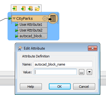

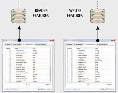

Once a format attribute is exposed on a reader feature type, then an AttributeCreator transformer can be used to change its value. But this won’t have any effect unless the translation is reading and writing from the same format.
On the other hand, exposing a format attribute on a writer feature type doesn’t make that attribute available in the workspace in the same way (that is, it is not exposed back upstream).
So, the most common method is to use the AttributeCreator transformer, but actually create the writer attribute and set it. For example, create autocad_block_name and set a value for it.
Used this way, the action is more like a Feature Type parameter; that is, it applies to all features written to that feature type.

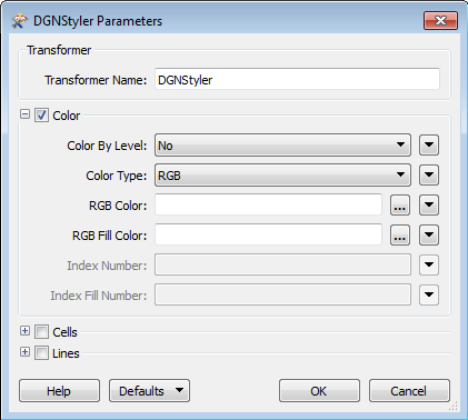

The DGNStyler helps a user to define the symbology of features to be written to a MicroStation Design File. It is really just a more pleasant way of using format attributes.
