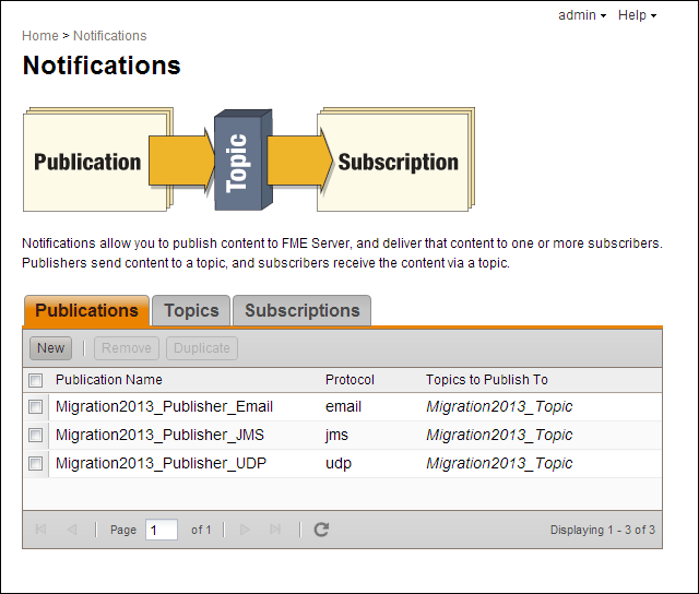

Publications specify the content of a topic that is sent to a subscriber. Click on the Publications tab to open the table view of publications. You will see a list of publications, the topics to which each one publishes, and the communication protocol used to send the notification.
To create a publication and associate it with topics, click on the New button.

To modify an existing publication, click on the publication entry in the table. A dialog similar to the one used to add new subscribers will appear populated with the properties of the selected subscriber. Make changes as needed and click OK.
To remove an existing publication select the publication row from the table and click Remove.
