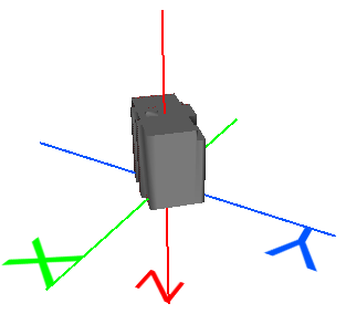

Original 3D Object |
This 3D building model is centered at the origin (0,0,0) and its units are meters. It is not georeferenced. |

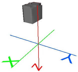

Translate |
Move the geometry a fixed distance. |
x' = 1x + 0y + 0z + D Simplified: x' = x + D D = X offset H = Y offset L = Z offset |
Move object 22 meters along all axes: x' = 1x + 0y + 0z + 22 y' = 0x + 1y + 0z + 22 z' = 0x + 0y + 1z + 22

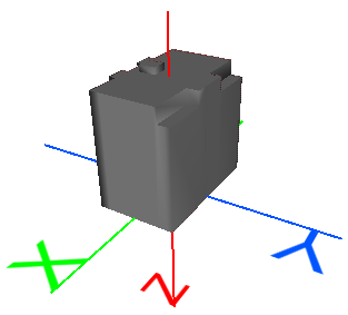

Scale |
Shrink or enlarge the geometry. |
x' = Ax + 0y + 0z + 0 Simplified: x' = Ax A = X scale factor F = Y scale factor K = Z scale factor |
Enlarge object by a scale factor of 1.5: x' = 1.5x + 0y + 0z + 0 y' = 0x + 1.5y + 0z + 0 z' = 0x + 0y + 1.5z + 0

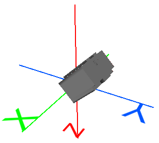

Rotate about X |
Rotate the geometry around the X axis. |
x' = 1x + 0y + 0z + 0 Simplified: x' = x ϴ = Angle in degrees F = cos(ϴ) G = −sin(ϴ) (Note negative value) J = sin(ϴ) K = cos(ϴ) |
Rotate object by 45 degrees around the X axis: x' = 1x + 0y + 0z + 0 y' = 0x + 0.70711y + −0.70711z + 0 z' = 0x + 0.70711y + 0.70711z + 0

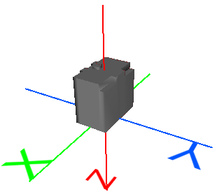

Rotate about Y |
Rotate the geometry around the Y axis. |
x' = cos(ϴ)x + 0y + sin(ϴ)z + 0 Simplified: x' = cos(ϴ)x + sin(ϴ)z ϴ = Angle in degrees A = cos(ϴ) C = sin(ϴ) I = −sin(ϴ) (Note negative value) K = cos(ϴ) |
Rotate object by 45 degrees around the Y axis: x' = 0.70711x + 0y + 0.70711z + 0 y' = 0x + 1y + 0z + 0 z' = -0.70711x + 0y + 0.70711z + 0

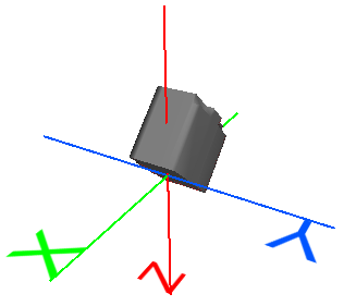

Rotate about Z |
Rotate the geometry around the Z axis. |
x' = cos(ϴ)x + −sin(ϴ)y + 0z + 0 Simplified: x' = cos(ϴ)x − sin(ϴ)z ϴ = Angle in degrees A = cos(ϴ) B = −sin(ϴ) (Note negative value) E = sin(ϴ) F = cos(ϴ) |
Rotate object by 45 degrees around the Z axis: x' = 0.70711x + −0.70711y + 0z + 0 y' = 0.70711x + 0.70711y + 0z + 0 z' = 0x + 0y + 1z + 0
