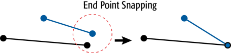

When this parameter is set to End Point Snapping, the transformer:

This parameter applies only when the end point of a feature is being snapped. It controls how lines are modified when they are snapped.

The example below illustrates end points of two line features snapping together.
