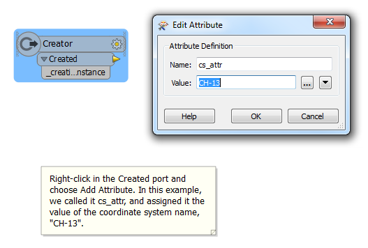

The following example shows how to set a feature’s coordinate system based on an attribute value.
Input features should have this attribute set to the FME coordinate system name as shown in the Coordinate System Gallery (the example below uses "CH13"). This example provides input features with their "cs_attr" attributes set to "CH-13".

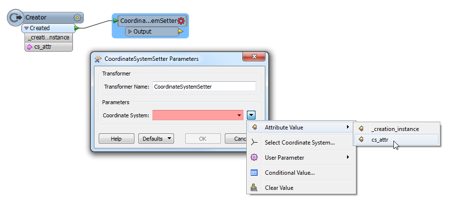

Click the Properties button in the CoordinateSystemSetter transformer. Click the down arrow beside Coordinate System and select AttributeValue > cs_attr.
