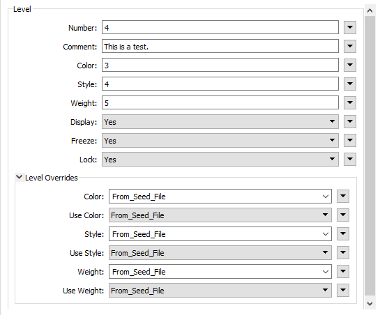

Example
Open the Feature Type dialog.
In this case, the level was set with the level name test2, and set with the corresponding level number of 4, comment, and symbology as defined above.

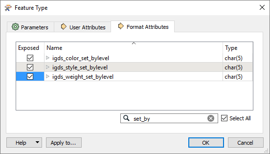

Note that if any feature being written to this level is intended to have symbology by_level, then the attributes igds_color_set_bylevel, igds_style_set_bylevel, and igds_weight_set_bylevel must be exposed in the Format Attributes tab:
