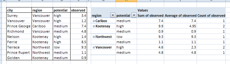

Fictitious data generated in Excel was exported it to a CSV file for use in Workbench. A simple pivot table was also created in Excel to show what we want to produce from FME; basically we want to summarize observed values based on region and potential.

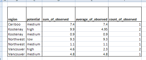

The workspace shown below uses the StatisticsCalculator transformer to create statistics for the observed attribute by first grouping features by region and potential. Then the new statistics features are sorted by region and potential, and output to a CSV file. The resulting CSV file has all of the same attributes/fields as the Excel pivot table.
The table written by FME and viewed in Excel resembles the Excel pivot table:
