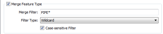

For reader feature types, you can specify Merge properties.

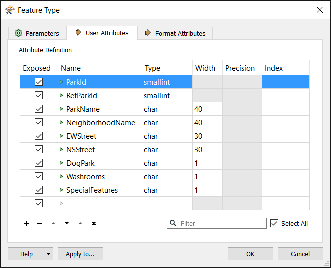

These options allow you to specify the attributes that are read when the workspace is run. Limiting attributes that are read can improve performance and reduce memory consumption.
This table shows the structure of the source data, including attribute names and their types.
Attributes that are checked under Exposed are shown on the canvas and can be referenced from downstream transformers and writer feature types. Unchecked attributes are hidden in the workspace, but are still read at runtime, unless 'Attributes to Read' is set to Exposed Attributes.
This table automatically populates when you add a new reader. If the structure of the source data has changed or is no longer current, you can update it.
You can enable the ability to edit the Attribute Definition table. On the Workbench page, check Allow reader feature type editing.
Note: Some readers do not support editing the Attribute Definition table, regardless of this setting.
These are built-in FME attributes that you can "expose" or make visible so that you can set them to particular values and connect them to other format-specific attributes. Apply to... exposes the attributes for multiple, selected feature types.
When you select (expose) an attribute on the reader side, it allows its value to be used in the workspace.
If you deselect an attribute, the attribute will no longer be exposed, but it will still be carried on the feature (even though it will be hidden from Workbench schemas).
