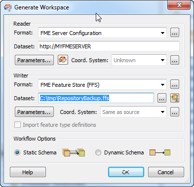

You can use FME Workbench and the FME Server Configuration reader to back up your existing configuration.
Note: The FME Server Configuration reader is available in FME Desktop 2013 or later. For more information, see the FME Readers and Writers Help, included with your FME Desktop installation

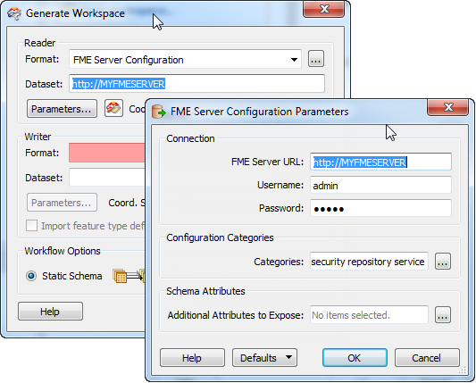

To back up your FME Server configuration from Workbench:
The Generate Workspace dialog opens.

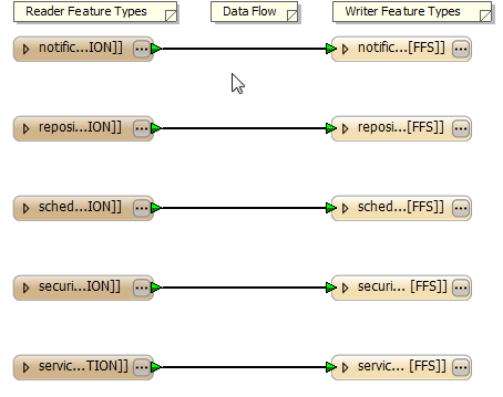

The initial workspace opens.
Note: When the workspace is created, you can still remove categories (feature types) that you do not need to export. Select them in the workspace, and then click Delete.
to run the workspace.
