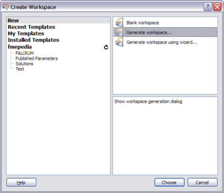

To back up your FME Server repository from Workbench:
For example, if you are backing up FME Server 2011, use FME Desktop 2011.

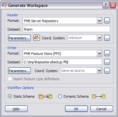

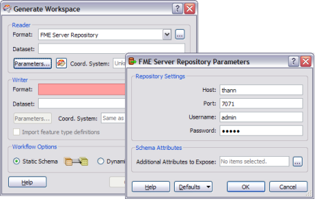

The Generate Workspace dialog opens.

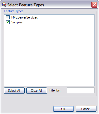

The Select Feature Types dialog opens.
Each feature type represents an FME Server repository. The FMEServer Services feature type contains the workspace service registration information, which you should keep, in most cases.
