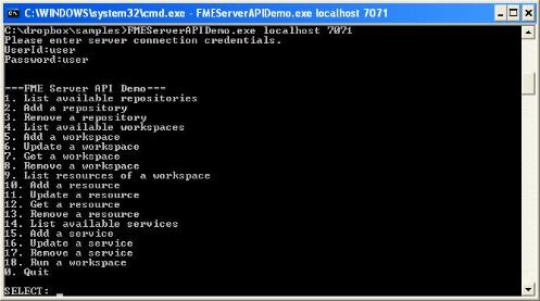

API Demo - Java
For demonstration purposes a sample command line application has been created to illustrate many of the common FME Server API concepts with sample code. The sample command line application takes two parameters. The first parameter is the FME Server host name and the second parameter is the FME Server port number. When the command line application is executed, you will be prompted for your credentials. (Leave blank for security-disabled configurations.) Upon verification, a menu is displayed which prompts you to select a given command. Additional information may be required depending on the command selected.
Sample code is available in Java, C++ and .NET. Please refer to the Java Quick Start for information on how to set up your development environment.
