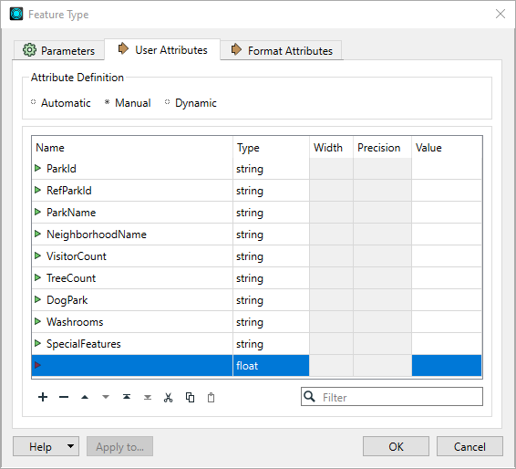

How to add a new attribute to a feature type:
  1. Double-click a writer feature type. (You can also click the gear icon in the pop-up toolbar and then click the User Attributes tab.)
  2. Under Attribute Definition, select Manual.
  3. Enter the name of the attribute and use the tab key to move through the Type, Width, Precision, Value, and Index fields. You can enter or change the default values provided in these fields, or continue to enter more attribute names.
  4. Warning  Avoid naming user attributes with the prefix fme_. FME may not recognize a user attribute prefixed with fme_ because FME uses this prefix to process many format attributes. As well, to prevent similar conflicts, avoid naming user attributes with the same names as other format attributes.
  5. Click OK.
  6. Connect the attribute with its source.
