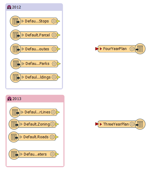

You have several input feature types and you want to connect them to one or more output feature types. Manually connecting each one would take some time:

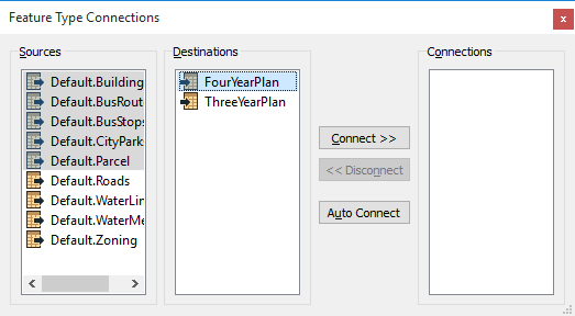

In the Feature Type Connections window, under Sources, select the input feature types you want to connect (Shift+click to select multiple lines at one time, or Ctrl+click to select individual sources). Under Destinations, select the destination feature type to which you want to connect the source feature types.
Click Connect.

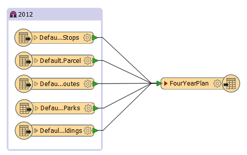

All the feature types are connected in the workspace:
