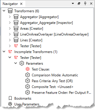

If you see an Incomplete Transformers parameter in the Navigator, it means that the workspace contains one or more transformers that need parameters filled in before the transformer will be operational.
Any transformer with a red exclamation warning will appear in the list. (Transformers with a yellow warning do not appear in this list, since they will not prevent the workspace from running.)
The Navigator displays a list of potential issues, and the problem parameters are shown in red. Most times, you will just need to enter or set a value, the parameter icon will change to green, and the transformer will be removed from the "Incomplete" list.
