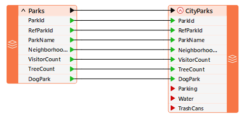

You have one input attribute that you want to connect to several destination attributes. Manually connecting each one would take some time. This is a simple example that shows a few attributes:

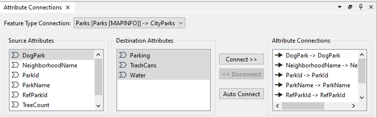

In the Attribute Connections Window, select the applicable Feature Type Connection, then select the Source Attributes you want to connect (Shift+click to select multiple lines at one time, or Ctrl+click to select individual sources). Select the Destination Attributes to which you want to connect the selected Source Attributes.
Click the Connect button.
Note  The Auto Connect button is useful if there is a clear relationship between attribute names (for example, they have the same name on both the reader and writer side).

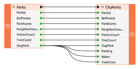

The attributes are connected in the workspace:
