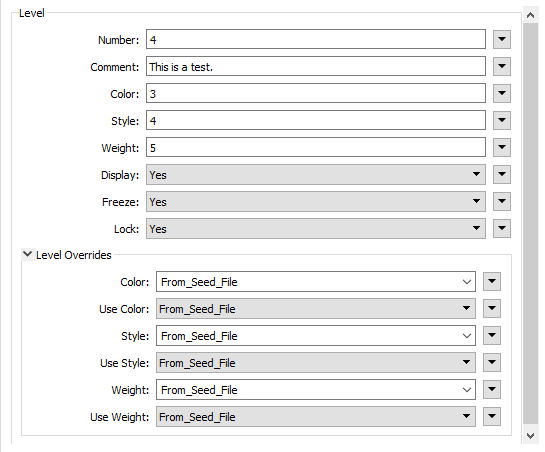

Open the Writer Feature Type Parameters:
DGNV8 writer feature type dialog, with example parameters

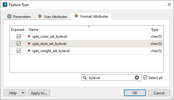

Note that if any feature being written to this level is intended to have symbology by_level, then the attributes igds_color_set_bylevel, igds_style_set_bylevel, and igds_weight_set_bylevel must be exposed in the Format Attributes tab:
DGNV8 writer feature type dialog, with exposed format attributes
