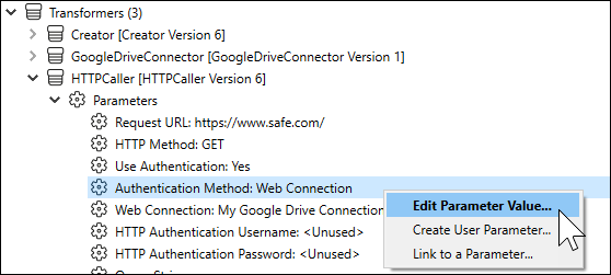

You can use an existing web connection, or define a new one, in Transformer Parameters, Add Reader, or Add Writer dialogs.

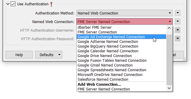

After you create a connection, it is available for you to reuse along with any others you have created:
