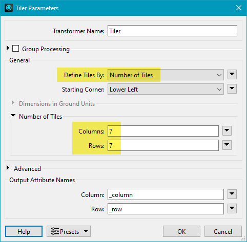

Writing Large Mesh or Point Cloud Features
The writer does not split up features. For example, if a feature written is one large mesh, there will only be a few tiles written. The result will be tiles with too many faces, and this will likely make rendering slow on the client side.
In this case, you can divide the mesh into more features. One way to do this is by inserting a Tiler transformer, and setting Define Tiles By to Number of Tiles.
  • Columns – Specify the number of tiles desired along the x axis.
  • Rows – Specify the number of tiles desired along the y axis.
For example, if you set both Columns and Rows to 7, this will yield 47 tiles.
Note that this solution can also be used to break up other single-feature datasets such as point clouds when writing them to 3D Tiles.
