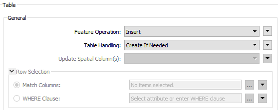

Many writers share a Feature Operation specification, which determines how features will be written into the destination table.
Note  Feature Operation supersedes Writer Mode.
Supported feature operations are described below. Note that the described behavior can be dependent on the selected options, as well as the underlying table properties.

Update Spatial Column(s) is a writer format parameter that is in effect only when the feature operation for a feature is Update. Possible values for this parameter are:
  • Yes: The spatial column(s) specified by the user will be updated. IFMENulls will be written as null values and replace existing spatial values. Some exceptions exist for multiple geometry column handling.
  • No: The spatial column(s) will not be updated.
Row Selection is a writer format parameter group that is in effect only when the feature operation for a feature is Update, Upsert, or Delete. When modifying a table, a condition needs to be specified for selecting which rows to operate on. This parameter group offers two ways to construct the selection condition:

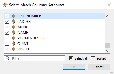

  • Match Columns: The column(s) chosen in the corresponding column picker dialog will be used for matching destination rows. All matching rows will be selected for update, upsert, or delete. If any feature attributes corresponding to the specified match columns contain null or missing values, the feature will be rejected.

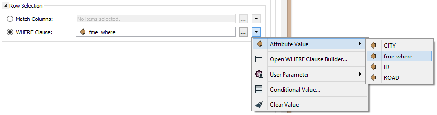

  • WHERE Clause: The corresponding WHERE Clause Builder lets you construct a WHERE clause. You can also type in a WHERE clause inline, without launching the WHERE Clause Builder. (It is optional to start the clause with the keyword WHERE.)
  • The WHERE Clause Builder makes it easy for users to reference feature attribute values, destination table columns, and invoke FME functions. The WHERE clause is first evaluated as an FME expression, before being applied onto the destination table.
  • The user can set the WHERE clause to any attribute on the feature. For existing FME users, the familiar fme_where attribute now must be specified via a WHERE Clause for it to take effect (see example above).
  • If the WHERE clause is invalid, the feature will be rejected or the translation will fail, depending on the specific writer.
  • For advanced users, conditional WHERE clauses can be created through the Conditional Value editor, to accommodate different groups of features.
