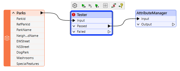

You can "drag and insert" a transformer onto an existing connection. The connection will turn green.
Release the transformer to set its place.

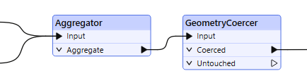

You can also insert into multiple existing connections. Drag a transformer over a port (shown highlighted in pink), and drop it into place.
Release the transformer to place it.

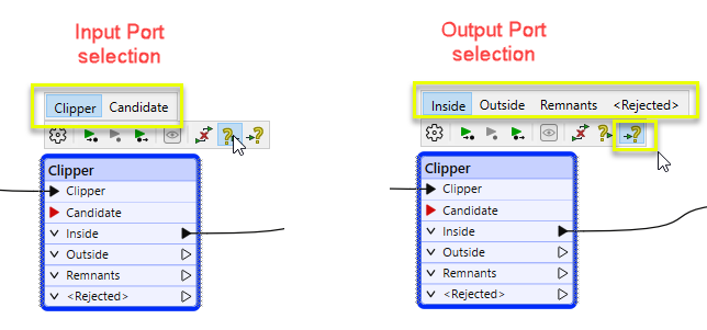

You can connect a single transformer into multiple input ports that require separate connections. A Clipper transformer, for example, has multiple input ports that require separate connections.
The first connection is easy. When you place the transformer over the connection, the connection toolbar allows you to set specific ports. Click the input and output buttons and then select the ports from the list of ports that appears above the button:
