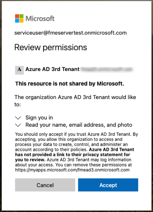

  4. Sign in as the administrator. A dialog opens that allows you to grant secondary tenant access to FME Flow.
  5. Mouse-over for example:

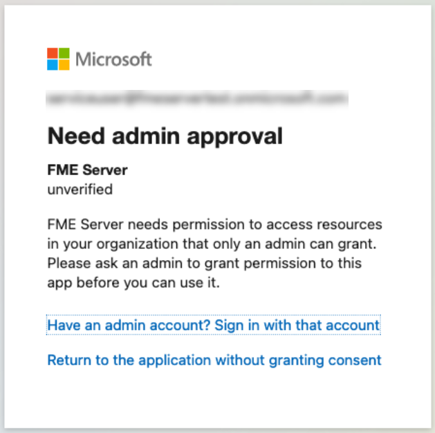

  2. A “Need admin approval” dialog opens.
  3. Mouse-over for example:

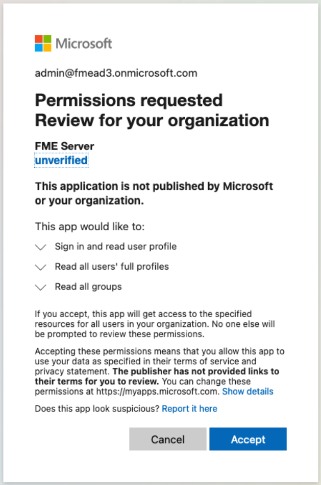

  5. A dialog opens that allows you to grant FME Flow access to secondary tenant users and groups.
  6. Mouse-over for example:
