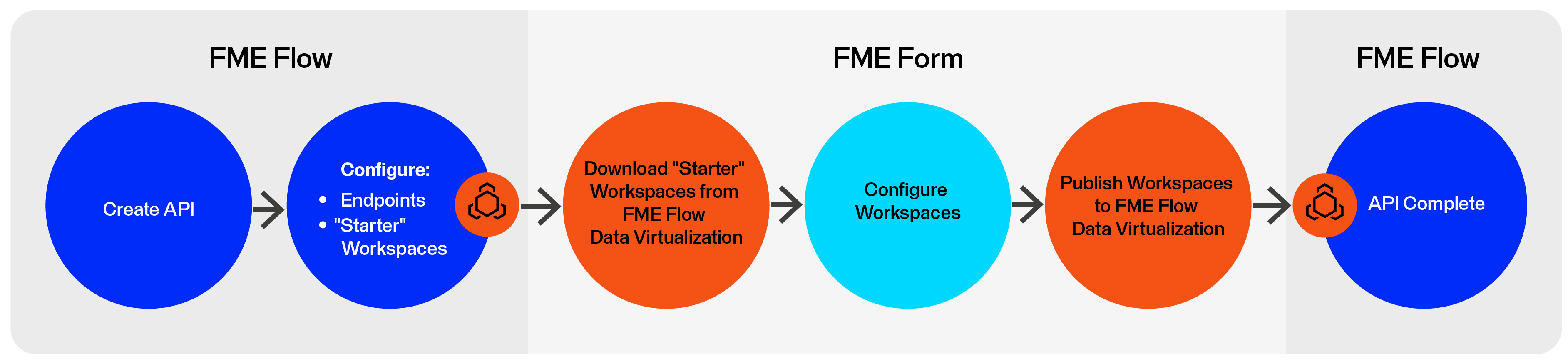

How It Works
The easy-to-use interface gives you all the tools you need to define endpoints and configure them with "starter" workspaces. Once your endpoints and workspaces are configured, download the workspaces to FME Workbench and configure your data access and transformation requirements. Your API is complete when you republish your finished workspaces to FME Flow Data Virtualization.

Follow these steps to create a Data Virtualization API:
  1. Create the API: Give the API a name and namespace. Configure initial security, caching, and provide other metadata. See Creating and Managing Data Virtualization APIs, below.
  2. Configure API functionality: Define endpoints and configure with "starter" workspaces. If desired, define reusable data property schemas for endpoints. Adjust security and metadata as desired. See Configuring API Functionality, below.
  3. Download workspaces to FME Workbench, configure data access and transformation requirements, and republish to FME Flow Data Virtualization. These steps are handled in FME Workbench. For more information, see the following topics in the FME Workbench help:
