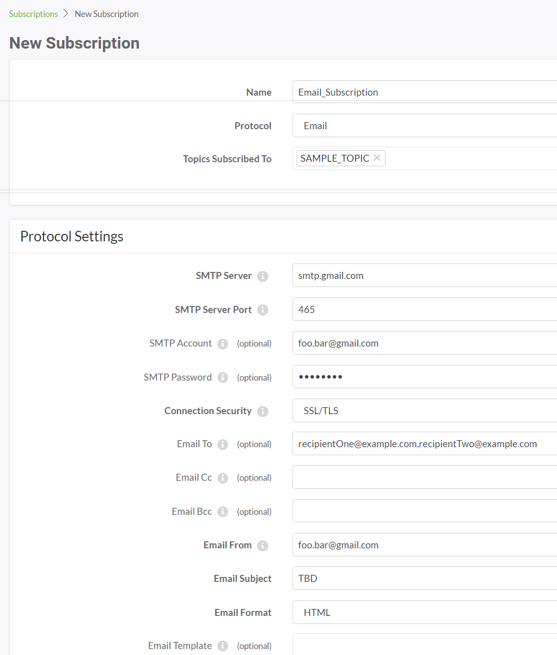

In the FME Flow Web User Interface, select Notifications > Subscriptions, and click Create.
Settings
  • Name: Specify a name for the subscription.
  • Protocol: Select Email.
  • Topics Subscribed To: Specify the Topics you want to subscribe to using the drop-down selector. To create a topic and use it right away, click +.
  • SMTP Server: Mail exchange server domain name or IP address used for sending email.
  • Tip  To auto-populate some fields for common SMTP servers, click Load Template.
  • SMTP Server Port: Mail exchange TCP port used for sending email. If Connection Security (below) is SSL/TLS, specify port 465. If StartTLS or None, specify port 587.
  • SMTP Account (optional): If the SMTP server requires authentication, this is the user name.
  • SMTP Password (optional): If the SMTP server requires authentication, this is the user password.
  • Connection Security: The encryption mechanism used for the connection.
    • SSL/TLS: The connection uses Transport Layer Security (TLS), formerly Secure Sockets Layer (SSL), supported by most common SMTP email servers.
    • StartTLS: An SSL/TLS connection with the email server is initiated using the STARTTLS command.
    • None: The connection is unencrypted.
  • Email To, Email Cc (optional), Email Bcc (optional): Corresponds to the To, CC, and BCC fields, respectively, in standard email messages. Separate multiple recipients with commas. For example: recipientOne@example.com,recipientTwo@example.com,recipientThree@example.com
  • Email From: Corresponds to the "From" field in standard email messages. If users reply to the notification email, it is directed to this address.
  • Email Subject: Corresponds to the "Subject" field in standard email messages.
  • Email Format: The format of the email. Options are Plain Text, HTML, or Rich Text.
  • Email Attachment (optional): Path to the source file to attach to the email.
  • Email Body (optional): The message body to use for delivery. This is a template that allows the use of various tags that are replaced with dynamic information before delivery. For more information, see Email Template Language.
  • Client ID (optional): For open authorization (OAuth) as a registered application with the Microsoft identity platform, specify the Application (client) ID. The client ID is created when configuring an Azure Active Directory tenant.
  • Note  A client secret is not required.
Example
Mouse-over to see the full image:
