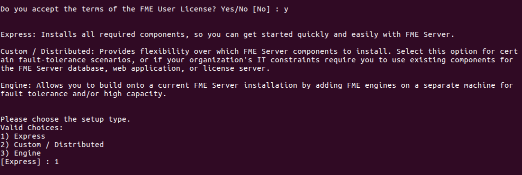

Proceed through to the Choose Setup Type prompt. Select the Express option.
Proceed through all the prompts. For each prompt, the default answer appears in square brackets, such as [default]. If you press Enter without typing an answer, you are accepting the default answer.
