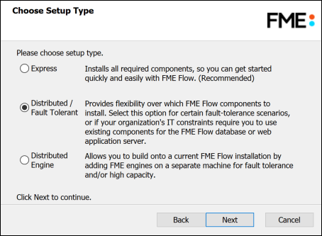

Choose Setup Type
Select the Distributed/Fault Tolerant install option.

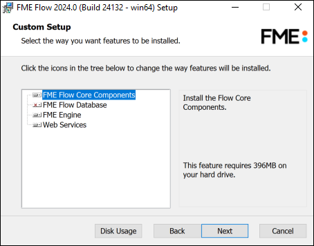

Custom Setup
Select FME Flow Core Components, FME Engine, and Web Services.
Note  The FME Flow installer does not distinguish between the settings Will be installed on local hard drive and Entire feature will be installed on local hard drive. In either case, the entire feature is installed on the local drive.

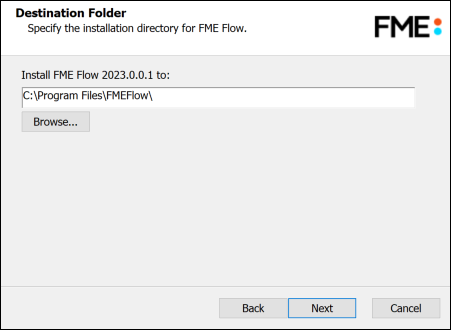

Destination Folder
Specify the installation directory for FME Flow. Do not specify a UNC path.

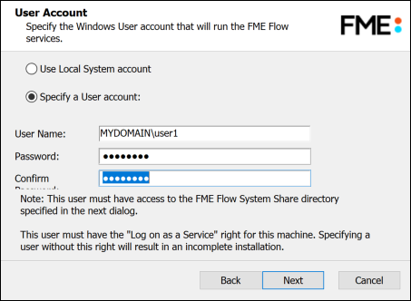

User Account
Specify the Windows user account that will run the FME Flow System Services. This account must have:
  • Read/Write access to the FME Flow System Share that you specify in the next dialog. The System Share is the location where FME Flow stores Repositories and Resources files. It must be accessible by all machines that comprise the FME Flow deployment. (For more information, see Provide a Remote File System for the FME Flow System Share.)
  • Read/Write access to the FME Flow installation directory that you specified in the previous dialog.
  • "Log on as a service" rights on this machine. For more information, see this Microsoft Docs article.
Note  The FME Flow Database service always runs under the local system account.

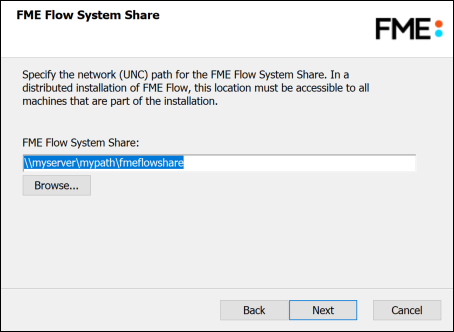

Specify a shared directory visible to all machines that make up the FME Flow. This directory stores FME Flow System Share files, which include Repositories and Resources. If this is a Linux installation, specify the mounted directory. For more information, see Provide a Remote File System for the FME Flow System Share.
Note  If you are upgrading to a newer version of FME Flow, ensure the specified directory is empty of files from the previous installation. Otherwise, conflicts may occur that can produce unexpected results in performance.

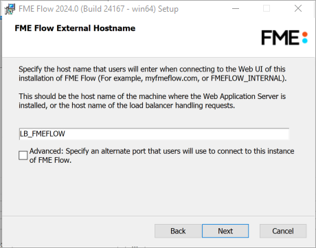

FME Flow External Hostname
Specify the name of the load balancing host through which FME Flow is accessed.
If the load balancer listens on a port different from the FME Flow Web Application Server Port (below), check Advanced and provide the External Web Traffic Port.
Note  Do not specify "localhost".

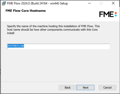

FME Flow Core Hostname
Specify the name of the machine hosting this installation of FME Flow.

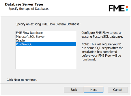

Database Server Type
Specify the type of database for the FME Flow Database. If you installed, on a separate machine, the PostgreSQL database included with the FME Flow installer, select FME Flow Database. If you are configuring the FME Flow Database on your own database server, select the database server type: Microsoft SQL Server, Oracle, or PostgreSQL. For more information, see Provide a Database Server.

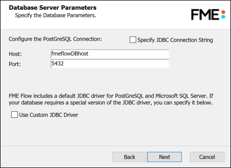

Database Server Parameters
Specify the connection parameters for the FME Flow Database. Optionally, to customize the connection parameters in the JDBC connection string, check Specify JDBC Connection String.
If Microsoft SQL Server was specified in the previous dialog, and it is a named instance of SQL Server, check Use SQL Server instance name to use that value instead of Port.
FME Flow includes a default JDBC driver for PostgreSQL and Microsoft SQL Server. If your database requires a special version of the JDBC driver, check Use Custom JDBC Driver and specify the JDBC Driver. If Oracle was specified in the previous dialog, you must specify the JDBC Driver.

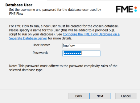

Database User
The installation creates a user account under which to use the FME Flow database. Specify a User Name (defaults to fmeflow) and Password for the database user account.
When specifying User Name and Password, keep in mind the following:
  • Take note of the User Name and Password that you specified. You may need to reference it later.
  • Password must not contain any single quote (') characters.
  • If you installed the PostgreSQL database included with the FME Flow installer, specify the same User Name and Password that you specified for Database User previously, under Install the FME Flow Database.
  • The specified Password is encrypted in FME Flow installation files.

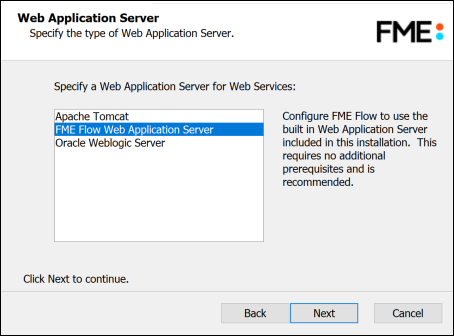

Specify the FME Flow Web Application Server.

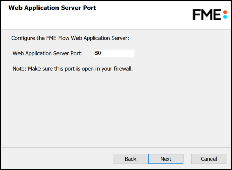

Specify the port to use for communication with the Web Application Server. On Windows, port 80 is the recommended default. If this port is in use, port 8080 is recommended. On Linux, port 8080 is recommended. If HTTPS was configured in the previous dialog, port 443 is set by default.
Note  Common applications that may be using port 80 include Skype and Internet Information Services (IIS). Either turn off these services, or select a different port, such as 8080.
