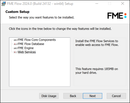

Custom Setup
Select FME Flow Core Components and FME Engine. Do not select FME Flow Web Services.
Note  The FME Flow installer does not distinguish between the settings Will be installed on local hard drive and Entire feature will be installed on local hard drive. In either case, the entire feature is installed on the local drive.

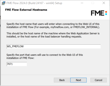

FME Flow External Hostname
Specify the Web Application Server hostname through which users will connect to FME Flow.
Additionally, specify the port for this connection.
