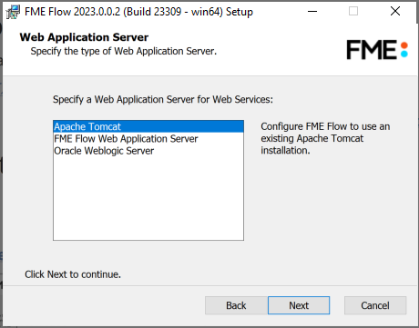

Web Application Server
Choose a Web Application Server:
This selection is valid if you have already completed the step to Provide a Web Application Server.

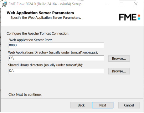

Web Application Server Parameters
Specify the connection parameters for the web application server.
The Web Application Server Port should be the same as the one that was specified when Apache Tomcat was installed. The default Apache Tomcat port is 8080.
The Web Applications Directory and Shared library directory can be found in the webapps and lib folder, respectively, under <ApacheTomcatInstallDir>/tomcat/.
This selection is valid if you want to use the Apache Tomcat web application server provided with the installer, and have not provided your own under Provide a Web Application Server.
