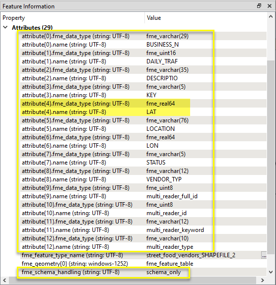

Schema features can be used to store or pass along schema structures - to dynamic writers, for example. The schema is stored in a list attribute named attribute, as shown here.
Each attribute has a name and an fme_data_type - note the attribute LAT has a corresponding data type of fme_real64.
Data types are FME internal data types.
