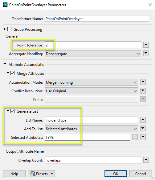

In this example, we start with a single point dataset of reported crimes, over many years. The points are routed into the Point input port of the PointOnPointOverlayer.
There are two tasks we want to accomplish.
First, we want to count how many crimes were reported at any given location within the dataset. The Overlap Count attribute will tell us how many other points were found within 2 meters of the location (as defined in the Point Tolerance parameter, with the data in a UTM projection, ground units in meters).
Second, we will build a list attribute that contains the type of each report in the location. We enable Generate List, and add the Selected Attribute TYPE to a list named IncidentType.
The points are output with no changes to their geometry, but with new attributes added. The example point selected now has an _overlaps value of 6, indicating that six points (crime reports) in total are at this location.
The IncidentType list collects the Type attribute from each of the matching points.
