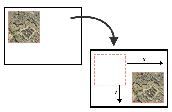

This example shows an image offset using the X Offset and Y Offset parameters:
