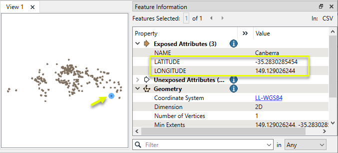

In this example, we have a dataset of world cities. The features have decimal degree coordinates as attributes. We want to convert those values to DMS.

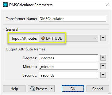

In the parameters dialog, Input Attribute is set to LATITUDE. Attribute names for the converted values - degrees, minutes, and seconds - are left with their defaults.

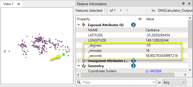

The output features have three new attributes, containing the converted values.

Features with decimal degree values stored as attributes.

Input Attribute |
Specify the source attribute containing the decimal degrees value. |
Degrees |
Name the attribute to contain the resulting degrees values. Note that if the decimal degrees value was negative, the resulting degrees value will also be negative, but the minutes and seconds values will be positive. |
Minutes |
Name the attribute to contain the resulting minutes values. |
Seconds |
Name the attribute to contain the resulting seconds values. |
