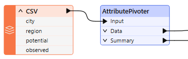

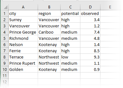

In this example, we start with a simple CSV table of statistics to be pivoted and analyzed. The CSV features are routed into an AttributePivoter.

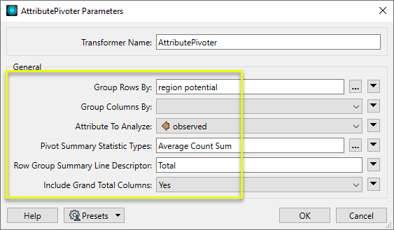

In the parameters dialog, we choose to Group Rows By region, then potential. The order is important.
The Attribute to Analyze is observed - the column containing our statistics. We have requested Count, Sum, and Average calculations.

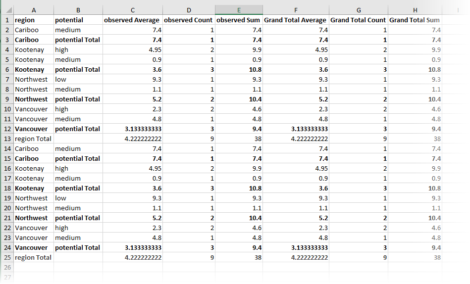

The output now contains the added statistics.
