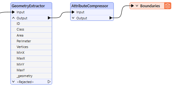

In this portion of a workspace, an input dataset with complex boundary polygons is to be loaded to a non-spatial database.

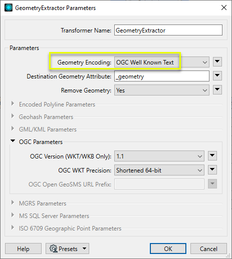

The first step is to extract the geometry and convert it to an attribute with the GeometryExtractor. Having selected WKT as the encoding type, the geometry is stored in the new attribute _geometry.
The features are then passed to the AttributeCompressor to optimize them for storage prior to writing to the database.
The features are then sent to the database writer, where the compressed attributes will be written as blobs and stored.

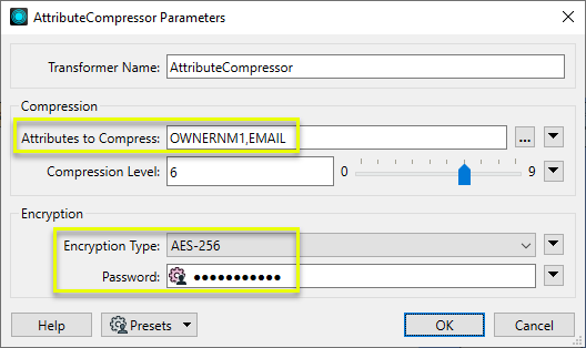

In this portion of a workspace, a table of owners is written to a database.
Using the AttributeCompressor, the names and email addresses are password-encrypted for an added layer of personal information protection in the database.
In this example, the password is being created by a user parameter that the user can assign as the workspace is run.

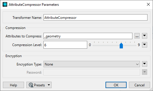

Attributes to Compress |
After connecting the transformer, click the browse button to select the attributes to be compressed and/or encrypted. |
Compression Level |
The value of this parameter controls the compression level which will be applied to the attributes. A value of 0 indicates that no compression should be used, while a value of 9 indicates that maximum compression should be used. The default value is 6. |
Encryption Type |
Use this parameter to select an encryption type. Currently, only the AES-256 encryption algorithm is supported. |
Password |
If encryption is being used, the value of this parameter will be used to generate an encryption key. The same value may then be used to decrypt the attribute values in the AttributeDecompressor transformer. |
