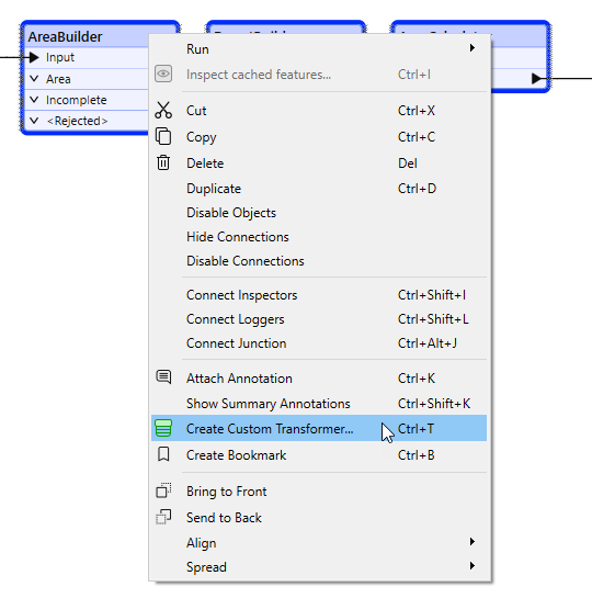

  2. Select a group of transformers: click and hold the left mouse button, and drag a box around the transformers. Release the mouse button.
  3. Press Ctrl + T, or right-click and select Create Custom Transformer.

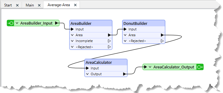

  6. Click OK. In this example, FME Workbench opens a new tab named Average-Area and the original group of transformers is shown on the canvas.
The input and output (if included) arrows are for reference only, to reflect the input/output to the custom transformer in the main workspace.

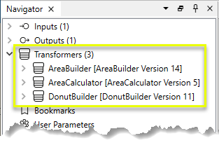

    When the custom transformer workspace tab is selected, the Navigator lists the transformers (and their attributes) that are part of the custom transformer.
    In the main workspace, the custom transformers, and their own parameters, are listed in the Navigator (much like any other transformer), except they appear as green icons:
