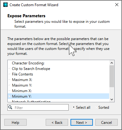

Expose Parameters
This list contains the possible parameters (depending on the selected format) that can be exposed on the custom format. Select the parameters that you would like users to specify when they use the format. For example, there may be parameters that are likely to change from workspace to workspace.
The parameters listed here will depend on your source data, and the ones you select will determine which parameters will be shown when you use the format in a translation.
