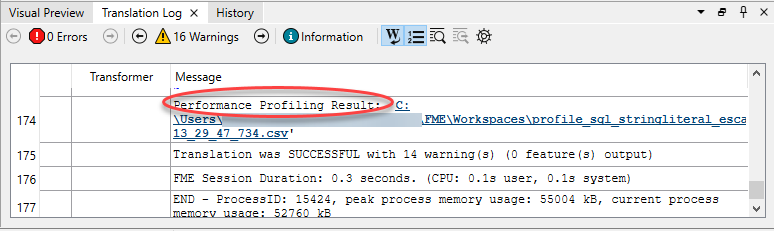

To obtain a performance report:
  1. Save the workspace.
  2. Check Enable Performance Profiling under the Run menu or Run Toolbar icon, or set the Enable Performance Profiling workspace parameter to Yes.
  3. Run the workspace.
  4. A link to the report appears near end of the translation log, beside "Performance Profiling Result:"
