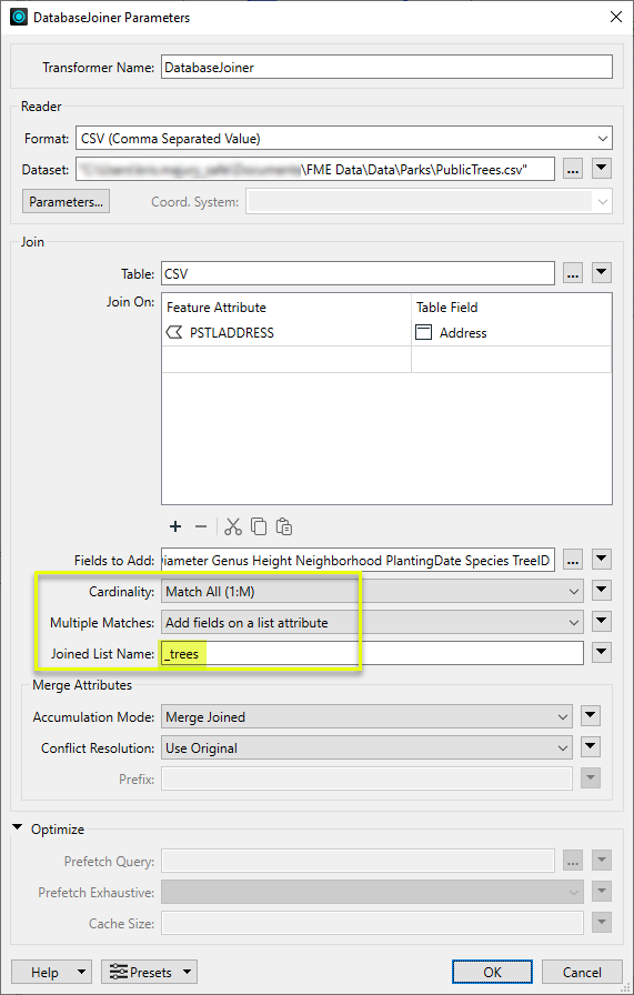

The company’s GIS technician uses the DatabaseJoiner transformer to connect the CSV records to the spatial data in a simple 1-to-1 relationship. The process works well until a particular address is found to have multiple records for multiple tree species. For example:
100 Dunsmuir St Redspire Pear
100 Dunsmuir St Chanticleer Pear
100 Dunsmuir St Flowering Cherry
How should the DatabaseJoiner transformer handle a single spatial feature with three attribute values? By default, it creates three output feature types, which is not desired.

FME solves this problem by enabling the DatabaseJoiner transformer to build a list, which permits any amount of values for a single attribute, and then providing a set of transformers specifically designed to handle this type of data structure.

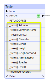

In FME Workbench, a list attribute is denoted by a pair of curly braces.
After the braces is a period ("." character) followed by the name of the attribute.
This transformer shows a list called "_trees" and a number of attributes in the list, such as "Species", "Diameter", "Height", and others:

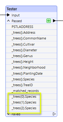

Each attribute in a list contains a set of values (elements). To actually obtain those values and use them in a workspace, they must be "exposed" as regular attributes.

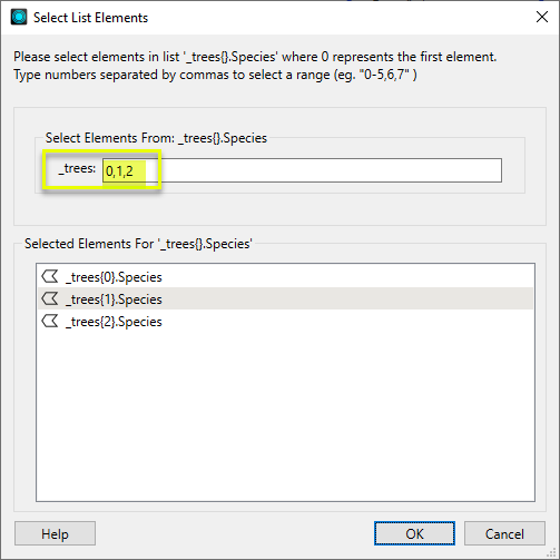

To expose elements, right-click on the list attribute and select Expose Elements. In the Select List Elements dialog, specify the elements of the list to expose. Here, the first three elements of the Species list will be exposed. (Notice that element 0 is used to signify the first element in the list.)
When elements in a list are exposed, they are added to the transformer as attributes. The name of the exposed attribute is the same as the list attribute name, except that the position of that item in the list is added as a number between curly braces.

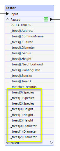

The process is repeated for the Height and Diameter lists.
In this example, three elements for attributes Species, Height, and Diameter were exposed; therefore nine additional attributes are now available in the workspace. The attributes (and their values from the previous example) are:
Attribute Value
_trees{0}.Species Redspire Pear
_trees{0}.Height 2
_trees{0}.Diameter 3
_trees{1}.Species Chanticleer Pear
_trees{1}.Height 3
_trees{1}.Diameter 2
_trees{2}.Species Flowering Cherry
_trees{2}.Height 9
_trees{2}.Diameter 3
