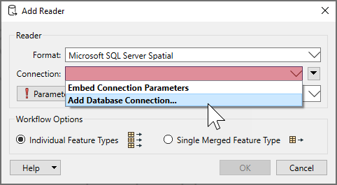

For example, when adding a Microsoft SQL Server Spatial reader, in the drop-down menu of the Dataset field, select Add Database Connection. (For file-based datasets, you must first choose Select Database Connection from the drop-down, then select Add Database Connection from the Connection drop-down in the Select Database Connection dialog.)

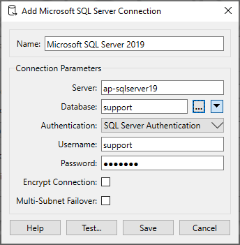

In the Add Database Connection dialog, specify the connection parameters, and give the connection a name (or accept the default), and click Save.

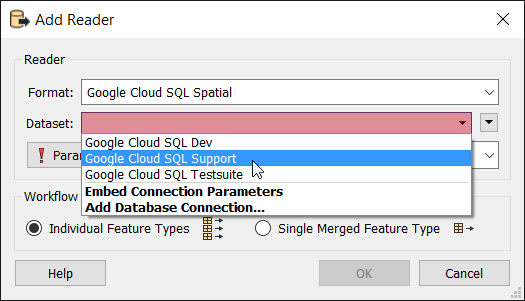

After you create a connection, it is available for you to reuse along with any others you have created that apply to the format or service:

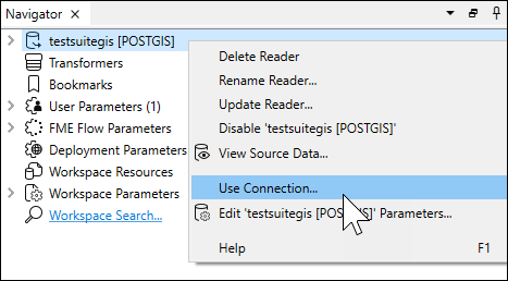

  • If the object that is using the connection is a reader or writer, right click on the reader or writer in the Navigator, and select Use Connection.

  • If the object using the database connection is a reader or writer, right click on the reader or writer in the Navigator, and select Embed Connection Parameters.
