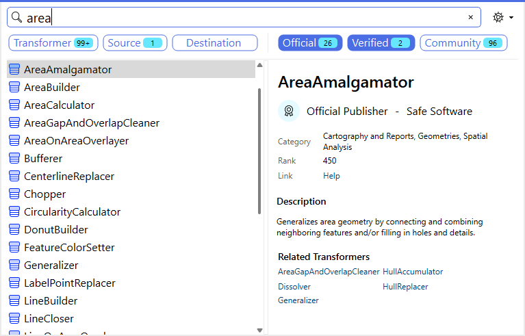

Quick Add is the easiest way to add transformers, custom transformers, readers, writers, and FME Hub items to the workspace. To try it, click on a blank area on the workspace canvas and press a key on the keyboard.
For example, type the word area. A dialog appears on the canvas that contains of list of items that contain the word area.
Select the item you want, press the Return key, and the item appears on the workspace canvas. Press Return again to open the parameters dialog.

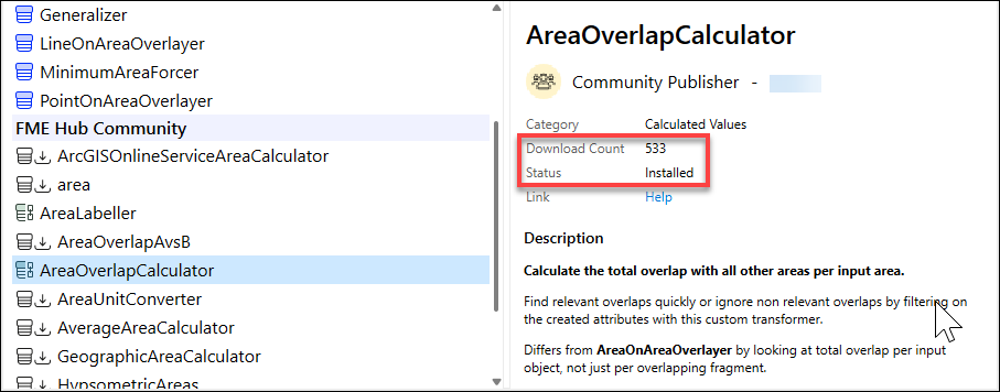

In the right pane description, selections are identified by their origin:
  • Official: Created by Safe Software Inc.
  • Verified: Created by a Verified FME Hub Publisher.
  • Community: Created by an FME Hub contributor.
Additionally, FME Hub selections show the number of times the item has been downloaded by users, and an indicator if the item is already installed on your FME platform:
Controlling Search Results
The top of the Quick Add dialog contains filters you can apply to your search results. You can limit results to:
  • Transformer
  • Source: In addition to readers, these results show transformers that read data from a source external to FME Workbench; for example, HTTPCaller.
  • Destination: In addition to writers, these results show transformers that write data to a destination external to FME Workbench; for example, FeatureWriter.
  • Official, Verified, and/or Community origin.
  • Applicable categories, if enabled. To enable, click the gear icon to the right of the search bar, and select Apply Category Filter.
