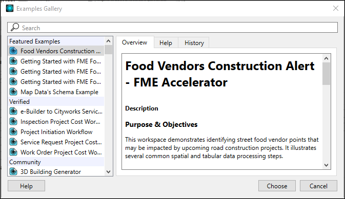

The Examples Gallery contains a list of examples, downloadable from FME Hub. You can use the Search bar to locate an example that contains a search term in the title or description.
Selections are identified by their origin:
  • Featured Examples: Created by Safe Software Inc.
  • Verified: Created by a Verified FME Hub Publisher.
  • Community: Created by an FME Hub contributor.
Downloading an Example and Saving as a Workspace
  1. To download an example, select it and click Choose, or double-click the example name.
  2. The FME Workbench log window shows the status of the download.
Note  If you have an open workspace, you will be prompted to save and close the workspace.
  1. When the example opens in FME Workbench, it will already contain input data and transformers (if applicable), along with explanatory annotations.
  2. Click File > Save to save the example as a workspace on your local drive. Additionally, FME creates a folder of the same name, in the same location, that contains any associated input data.
