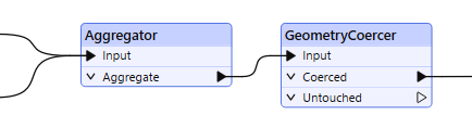

Inserting a Transformer: Existing Connection
You can "drag and insert" a transformer onto an existing connection. The connection will turn green.
Release the transformer to set its place.
If either object has multiple input or output ports, you will be prompted to choose how to set the connections.

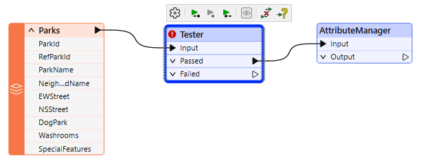

Changing Connections after Drag and Insert
Upon auto-connecting a transformer, a connection toolbar appears above the transformer . If you wish to remove connections while keeping the transformer on the canvas, click Undo Automatic Connection . To undo, add, or change input port connections, click Reconnect input port . To undo, add, or change output port connections, click Reconnect output port . The connection toolbar disappears when focus shifts away from the transformer.

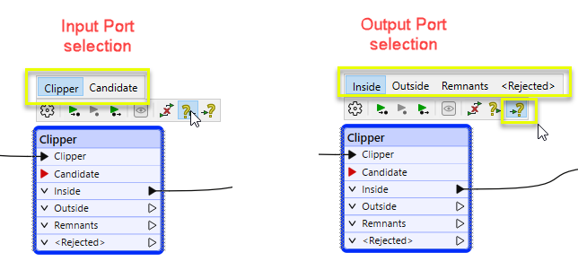

You can connect a single transformer into multiple input ports that require separate connections. A Clipper transformer, for example, has multiple input ports that require separate connections.
The first connection is easy. When you place the transformer over the connection, the connection toolbar allows you to set specific ports. Click the input and output buttons and then select the ports from the list of ports that appears above the button:
