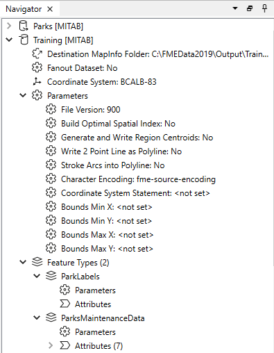

Reader/writer parameters are easily identified in the Navigator. The parameters apply to everything beneath them; that is, all datasets being read and all features types within those datasets.

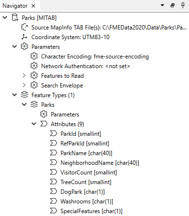

Some Reader (and Writer) parameters are only accessible through the Parameters button when you initially create a workspace or add the Reader/Writer to an existing workspace. This is because these parameters affect how the schema is read and therefore how the workspace is constructed. If you make a mistake when you set one of these parameters, you can always re-create the workspace.
Feature type parameters are accessible only with certain formats (like databases) and are at a lower level in the Navigator hierarchy. You can also access them through the Feature Type dialog.

To edit a parameter, double-click it. A dialog opens and you can edit the parameter’s value.
