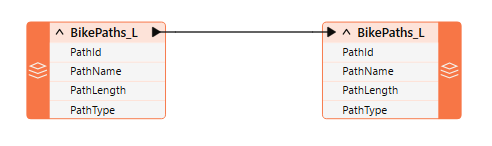

Below is a reader and writer schema as they appear in FME Workbench. Source data is on the left, and destination data is on the right.
Each item is a separate feature type. Here, there is one source and one destination feature type, and each feature type has a set of attributes.

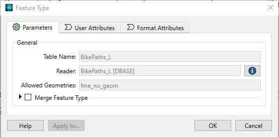

Above: The Feature Type dialog has a number of tabs that display information. Click the Parameters tab to view the feature type name, the name of the parent dataset for the feature type, and permitted geometry types.

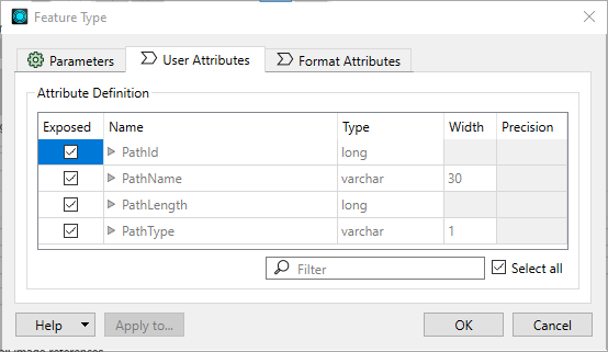

Above: The User Attributes tab shows a list of attributes present on the feature type. Each attribute is defined by its name, data type, width, and number of decimal places.

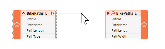

Feature Mapping is carried out by clicking on the output port of a source feature type, dragging the arrowhead across to the input port of a destination feature type, and releasing the mouse button.
Here, a connecting line from source to destination feature type is being created by dragging the arrowhead from source to destination:

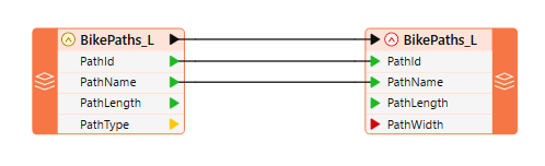

Attribute Mapping is carried out by clicking on the output port of a source attribute, dragging the arrowhead to the input port of a destination attribute, and releasing the mouse button.
Here, feature mapping has already been established and attribute connections are being made.

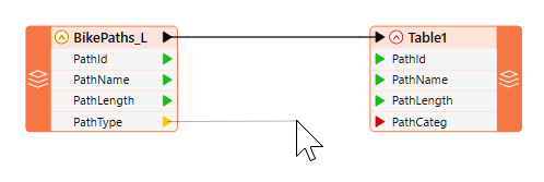

A new connection from PathType to PathCateg is being made. The other attributes have matching destinations so they are connected automatically (implied connection). Note the green, yellow, and red color coding showing which attributes have been connected.
